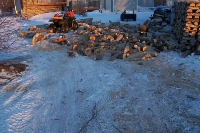

Haven't broke it yet, tried hard but the graphite rod is tough. Refined length to 17"
The way I cut is, I limb then drag the log to where I'll cut & load. I cut with it on when I can, sometimes put in on the small back up saw & use it to mark 17", still working good for me.
I can set my splitter so it only opens 18" & trips out, the 17" rounds always fit, save splitter time too :)
Call me anal, wife calls me worse.
An idea that works for me.
I am burning stuff now, before the jig, some fit N/S, & some don't. The long ones I use E/W for day burns & coal burn downs.
Amazing though, the short one always fit in N/S, go figure LOL :lol:
Tip I learned with it, have a few extra 1/4-20 nuts with you. Rare earth magnet may be in it's future.
