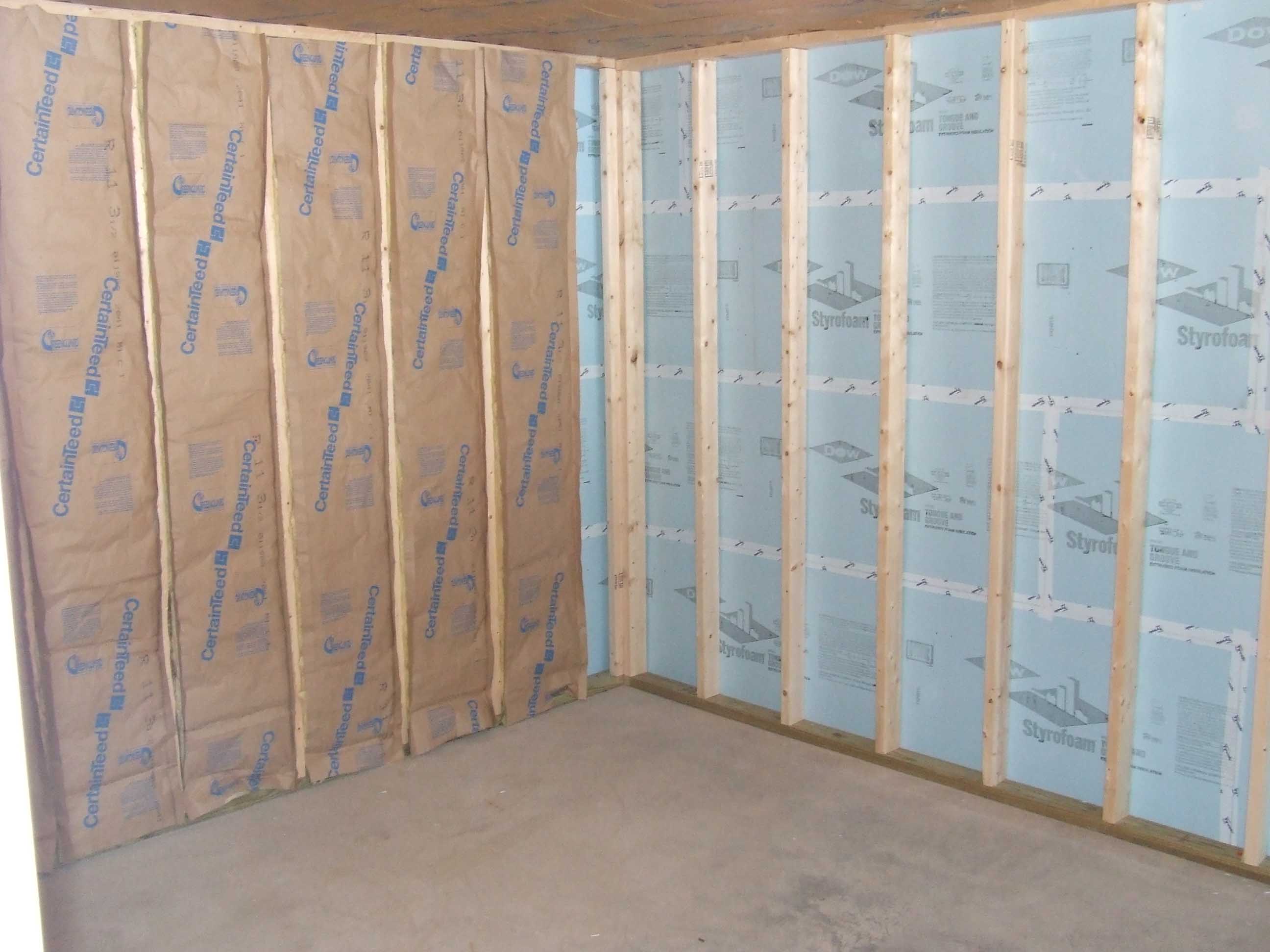

I'm planning on adding a studded wall with r13 batts insulation to most of the basement where it is possible.....

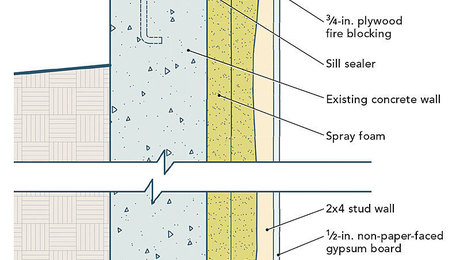

You absolutely do not want to insulate a buried basement wall with a fiberglass batt or any other porous insulation right up against the concrete. That's a recipe for a moldy wall and musty smelling basement. Use rigid foam board, glued on (with PL300 for example) or screwed on with concrete screws & fender washers. with all edges sealed. Over that apply 2x4s on the flat and screwed through, then covered with sheetrock held up off the floor. The sheetrock is for thermal and ignition protection; the 2x4s provide space for shallow electrical boxes. If you wish, the 2x4s (or 2x3s can be installed the normal way and the bays filled with FG batts.
There is plenty of information out there on why you don't want a FG batt against a basement wall, and plenty on how to do it the right way. Here are a couple of links:
