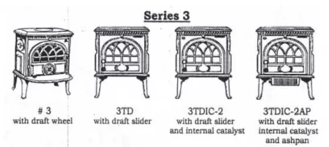

Russ, what's the specific model number on the rear plate?
It isn't a plain model 3. That is the non-cat. My guess is this is a 3TDIC. Can you identify from this picture?

3TDIC it is I guess. The back plate must fit snugly. You don't want flue gases going up behind the baffle. Have you tried going through your local Jotul dealer? That is the preferred route.
