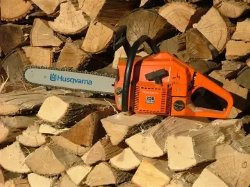

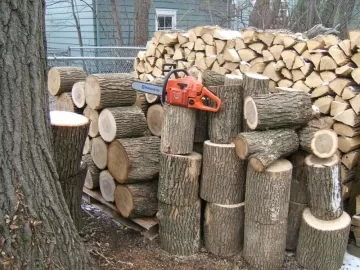

The MS180 you mention is a good little saw, but you will beat yourself and the saw up asking it to spend any amount of time in 12"+ wood. It just doesn't have the oomph for serious cutting. For trimming and clean-up, for packing along to clean up trails in the woods, or for limbing, it is a fine choice at a very friendly price. But you're looking at 4-5 cords/year, not two or three fallen limbs and a Christmas tree.
Don't get me wrong, I'm a fan of small displacement saws. You can get a lot of work done with them, and sometimes it is nice to just finish the job with a little saw. But a 50cc machine isn't that much larger in weight or bulk, but will cut with markedly more authority than most <40cc saws, and a competent 50cc machine can be had for less money than one of the few authoritative <40cc machines left on the market.
If you're set on something in the 35-40cc class, the new Echo 370 and 400 seem like very nice machines at a reasonable price. Dolmar's 401 is a good saw, too, and is one of the few with "pro" construction - vertically split magnesium crankcase, bolt-on cylinder. Shindaiwa and RedMax have good models in this displacement range, too, as does JD/Efco/Emak/CubCadet (the 40cc machine). The other offerings from Stihl and Husqvarna in this displacement class are either underwhelming (Husqvarna 142, Stihl 170/180/210/230) or price-prohibitive (Stihl MS200, Husqvarna 339). If you buy one of these smaller saws, buy from a dealer and see about swapping the 16" or 18" bars that the saws usually come with for a shorter bar - 13-14" would be about perfect. These little saws can cut if you can keep the revs up on them, which recommends a shorter bar - fewer cutters in the wood, less friction, etc. But with the overly long bars that they usually come with, they end up being poorer performers than they need to be and are asked to do things that they aren't all that well suited to do.
Attached are two pictures of my 38cc Husqvarna 238se. With its 13" bar it pulls hard even when buried in hardwood, and if you do your part to keep it in its powerband (use a light touch - it's a low torque 15,000rpm screamer), it cuts VERY fast. It is a great little firewood saw, a superb limber, and a light and nimble machine. It cut 1.5 cords of firewood last week alone - a mix of 5-18" ash, shagbark, and silver maple. A current vintage machine similar to this would definitely meet most of your needs, though it would quickly be outclassed in 20" wood, whereas the 50cc machine would have an easier time in that sort of stuff.

Hey Computeruser,
Your second picture, nice pignut hickory sitting on that white ash.........I am spoiled now from burning Hickory............
