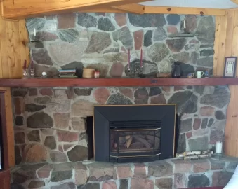

Here is a picture of the current fireplace for reference.
[Hearth.com] Best Flushmount Wood Insert Hybrid-Fyre, Ci2600, Epi 3c
I was very pleased with my Osburn Matrix... it worked great and looked fantastic. I changed to a bigger, freestanding stove since I use it as my primary heat source but I still miss the Osburn.
