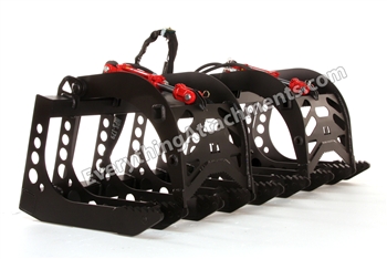

Think this may work well. Solid bottom so could be used as a bucket, sides are cut out so could still pick up logs. Would add a tooth bar...
Any thoughts?
[Hearth.com] Best grapple
Reactions: duramaxman05
Any thoughts?
Interesting hybrid. It will be about 50-75% good at both tasks. Loose material handling will be reduced with the sides cut out, but it will be a better grapple. Also looks heavy.
