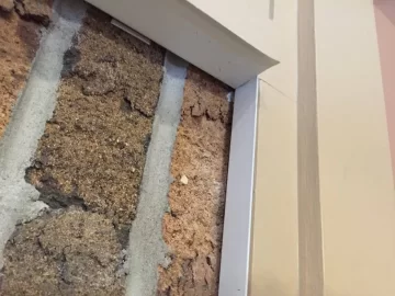

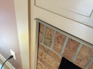

My surround was getting a bit hot on the closest edges to the stove. The underside of the mantle gets warm but seems fine. I bent some aluminum to protect the surround. I checked it on hot burns with the IR gun and it seemed to do the trick. I wanted my shields small and not real noticeable. Turned out pretty clean.
Thanks for the pics...I really like what you did. I thought about a heat shield to be extra safe above cast iron surround but don't like how they look. What aluminum material did you use, where did you get it...and how did you adhere it to the surround? Looks great and is just what I would like to do!
I used some pre-bent peices of building materials and slightly re shaped to my needs. I have some drop ceiling wall tracks on sides, and door head flashing across the top. Sell it all in Home Depot. I was able to slide it between the brick face and wood surround. It pretty much stays up on its own. Tucked in some extra thick pieces as shims to keep it tight. No nails, glue, etc...
