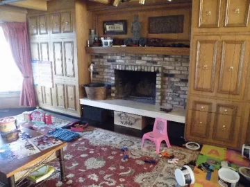

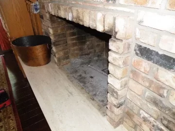

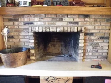

Well had the insert guy over tonight - he says everything is good to go. So I will start demo this weekend or next and start a new thread on it once I do.
But was so excited tonight that I took off the fireplace glass - it was then I realized that the fireplace opening is pretty big.
Thanks everyone for their help on this, I think I will attack it with an oscilatting tool + masonry dril bit + brick chisel + brick hammer + vacuum + drop cloth + prayers.
Well tried one brick and failed - a bit gun shy, the mason is coming tomorrow, will gladly part with my $250-$300 to get this done. The brick beat me today.
Yikes, I guess I am a minority of one here, but I say DON'T cut the brick. Just leave it, it looks fine. If you need to have a surround around an insert, you can have an insert surround custom cut so it sits nicely on the protruding brick level. Or you can put an insert without a surround which actually can look quite nice and give the appearance of a nice (though legless) stove in the fireplace, It would work the same as having the surround and you won't have to permanently change your brickwork.
I'm not sure I follow why all this work to remove 2-3" of brick. Why? If the surround "just covers" the protruding brick, why not just have the surround fit to the edge of the protrusion? I may be missing an important detail here, but if it just takes trimming a 1/2" off the surround metal or even 3", that seems like it might be an easier approach.
I would most definitely cut the metal surround to fit INSIDE the opening. It makes for a "clean" look.
