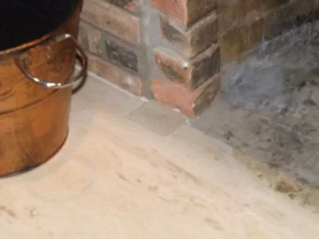

Well, the brick has been cut - now waiting on the install. I hired a mason and it was done with hammer and chisel.

I should be okay - the surround (at least according to the manual) will cover all the bricks, so I am happy. Also happy no brick poped out during the cutting.

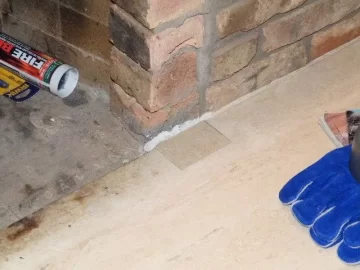

A minor thing I had to do myself, the hearth was cut to incorporate the brick, so when the brick got cut, it was exposed on the hearth and didn't look good. I had to dig out the remaining brick and put in some travertine there. I will post a picture in a bit (I have to go outside now, I got a leg of lamb on my smoker - it is Canadian Thanksgiving).

The pic of what I was talking about (there used to be brick where the new travertine tile is). The brick would have shown on the hearth in front if I didn't do this as the surround would not have covered it up. Not perfect, but not bad.

Hey, starting to shape up nicely. Will be looking good with new insert soon. Happy Thanksgiving to you, your family and all the northern neighbors.

Your repair looks fine, can't wait to see the finished product....and Happy Thanksgiving to you and your family.....that smoked lamb sounds tasty, now you got me hungry!!

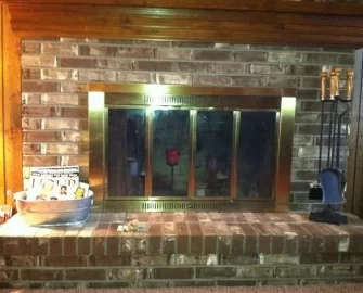

I just purchased a T5 insert last weekend. We had a Auroa freestanding wood stove in our prior house but it has been 14 years. We miss the heat from wood. My existing fireplace is pretty much worthless. I have only had 2 or 3 fires in it. The furnace run more with a fire vs without a fire, major up draft I guess.
The place I bought the T5 insert from says PE claims it isn't available until early 2012 but he seems to think he can find one through one of his distributors. I hope so because it's getting rather chilly here in Michigan. To say the least I am quite fired up :) about getting it installed & cooking. Here is a picture of my existing fireplace. I will post a picture of the new T5 when she gets installed. Hopefully sooner than later.
I was limited on my inserts due to clearances. From the hearth up to the first trim piece under the mantle was the issue. I did a lot of research & was going to get the VC Montpeiler but the T5 seems to be better built, better warranty & better suited for my needs. I am going to use it for a supplemental heat source & try to save a few $ on the natural gas.
Cap Cod style house approx 1800 sq ft plus a full basement.

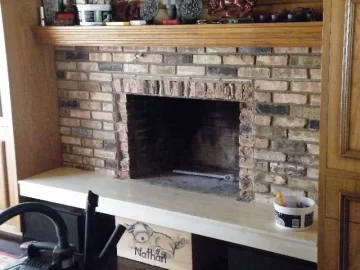

Wow - my fireplace screen looks very similar to yours (at first glance I thought it was mine). Well the T5 Insert story is as follows:
