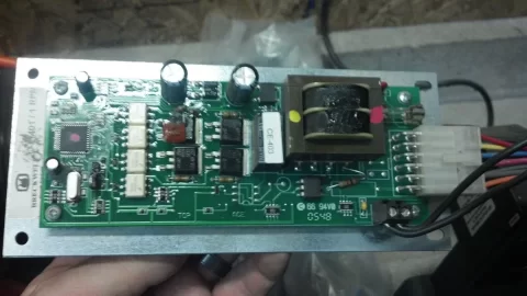

What model boards do you have? Snap a pic of the back side, I believe there was an update to the controller and it carried a 403 part number.

Well I came home from shopping today and it was off again, burn pot empty and #3 light blinking. Seems the auger stopped again, in heat level #4. I did not get a pic of the controller yet.

Here's a pic of the controller:
  • [Hearth.com] Big E Sporadic Auger Stoppage?
Looks like you already have the latest board. It seems like the board was already replaced, Probably for the reason you are discribing. The resistors near the triacs are the givaway. I just don't think its the board causing the problem.
