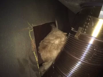

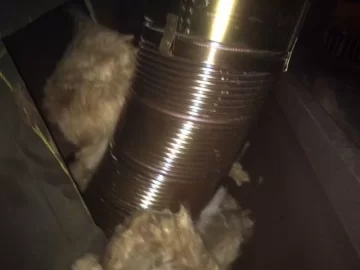

Heading into my second year of burning and boy have I learned a lot from this site — I took today off to get serious about some final wood splitting, a chimney sweeping and also taking a look behind my i2400 insert install. The install was done by a "professional" installer and, when I found this site after, I had the sinking feeling that I had been fed the usual lines others have heard: you don't need a block off, oh yeah we insulated it, etc.
Well, I opened up the surround from the insert and poked my head back there today...as I expected, there's some stray insulation hanging down around the flue but what I didn't expect was this massive hole cut into the metal fireplace surround itself right behind the liner connection. What the heck is that all about?
I need to get my father-in-law out here to help me pull the stove out and then I'm hoping to do something like this infamous insulation install with Roxul and Durock: https://www.hearth.com/talk/threads...lating-my-fireplace.75755/page-2#post-1629779
Either way, take a look at these pics — is this really screwy or what?
  • [Hearth.com] Big hole in my fireplace surround...
They did what they said, they stuffed some insulation up there. Make a block off plate and insulate that fireplace and you will see a big difference in heat output, especially if that is an exterior fireplace. The pics are crap but it looks to me like they cut out the damper to make room for the liner, pretty standard.
The only thing that is wrong that i see is the fact that they used fiberglass insulation. We would install a blockoff plate but that is not required and is not industry standard. As far as the hole goes we cut out the back to usually not that much but they may have had to to make it fit.
Well I'm with the OP on this one. While they may have had to cut what they did they did nothing in the way of insulating after. This was apparently discussed prior to the install leading the OP to assume it was done. Those couple of pieces of insulation are as good as having nothing. It would have taken very little effort or expense to do it right and the OP did not get what he asked for.
Fill the area above and below the damper down to a metal plate and you'll see great gains as Mellow said.
The op didn't say that the installer said they blocked it off. Only that they insulated it which the liner may very well be insulated. I agree it is not the greatest install but at least they didn't smash the liner to get through the damper. Unless the op spacifically asked for a block off plate and the installer agreed to it i don't see anything negligent at all. We do a better job yes but we also charge more than most.
No they didn't say they blocked it off. They said it was unnecessary then went ahead and did a shoddy insulation job to shut the customer up and were on their way. They have no idea how the stoves run that they have installed or how much better it could have been done. Poster after poster comes here with similar stories. "My installer says the plate isn't needed, it will cause failure and you don't need to insulate the liner, cats are bad". Heard it all.
Bholler I wish I could have found an installer who takes his profession as seriously as you seem to do. Believe me I looked and was willing to pay. But in my experience most dealers and installers have a know it all attitude which just happens to justify their wham bam thank you mam installs. I was unable to find an installer wiling to even concede that a block off plate might work never mind consider doing it. I had to insist on Roxul (never heard of it) and even when used it was installed in a similarly worthless way as the OP. This coming from the most knowledgeable dealer I could find. In the end I had to do it myself.

Thanks for the feedback, all. Yeah, those pictures are pretty crappy aren't they? For one they somehow got rotated when I uploaded but they were also taken in the small space between the top of the insert and the brick fireplace that I could fit my phone into. I'm going to pull the unit out this weekend with my FIL and get a better look.
I picked up the R15 "comfortbatt" of Roxul, a sheet of 26ga steel and a big sheet of Durock today. I'll make this right now that I know what I'm looking for thanks to the site.
As far as the installer, no I didn't use words like "block off plate" or "fire rated insulation" so that is on me and now I know better. However, it was discussed that both the bottom and top of the new liner were "sealed and insulated." I'm still not 100% sure why that square was cut out of the metal backing but I'll be able to see when we start taking it apart.
