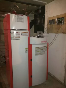

Good luck. Are you getting the Mass. rebate? Not sure if it's still in effect. Marc is great, he helped me out anytime I needed it.

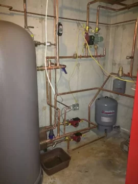

![[Hearth.com] BioWIN 210 Install [Hearth.com] BioWIN 210 Install](https://www.hearth.com/talk/data/attachments/165/165916-bcf7788488ea6597f8c74f3ab7d1db5a.jpg?hash=vW-ktGlpxj)
![[Hearth.com] BioWIN 210 Install [Hearth.com] BioWIN 210 Install](https://www.hearth.com/talk/data/attachments/165/165917-79a89ac6b98b4ac453e1170c42a5c5f9.jpg?hash=8cvCJ86hdo)

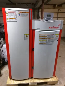

I might lay a few extra welds down to make sure the joints are really strong.

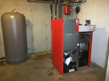

Nice job.Nearly finished the piping this weekend.
4" exhaust pipe, with two 15° bends each. There are two band clamps per pipe. One is to connect the steel pipe to the outside aluminum pipe. The other is in the middle so I can assemble/disassemble the pipe. Both band clamps are on the straight sections of pipe for maximum strength.
Still got to ground everything, and strap down the pipe but it is extremity solid right now.
