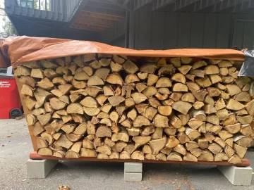

How thick are the average splits? That will affect drying time too. Is the wood top-covered, but open on the sides and stacked so that the prevailing winds can blow through the stacks? If so, the wood may be reasonably dry in 2 months. The thicker splits may still be > 20%, but if they are mixed with thinner splits then it could be ok.

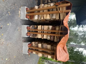

I wish I had more space in the garage for wood (the pic of uncovered wood is 3 rows deep, in the garage), but we are MAYBE having a volcanic eruption at some point here this winter here in Alaska and I need to keep room for vehicles in case of ash fall. There is a good chance of rain here every day for at least 10 days straight, so the top has to stay covered until I get a string of sunny days.

As a side note, with some treated 2x4s, some landscaping timbers (CHEAP), and a few cinder blocks, you can have some very cool wood racks for very little money. They may not be the most study on earth, but they're plenty sturdy for my needs. Plus, you can disassemble them and move them at will when empty.
