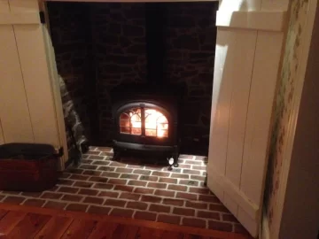

I did brick tile over cement board, for mine. My goal was to keep the hearth extension flush with the floor, so I was working within the 1" total thickness of my floor boards.

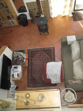

I did tile and the thing with the BK is that the temperature on the hearth is just above room temperature most of the time unless you burn hot. That is awesome.
Our whole floor is a hearth.
[Hearth.com] BK Floor Protection
We track in dirt and water from outside, so the last thing we want on our floor is wall to wall carpet or wood flooring. Porcelain tile always looks brand new even after decades of hard use... and we are hard on floors.
