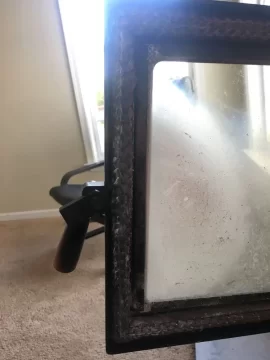

I think the issue is the alignment of the knife-edge and gasket; here’s a shot I just took, and while it’s kind of hard to see, the gasket is compressed on the outer edge of the gasket near the latch instead of the the center of the gasket.

I still thinking that the front E/W log cause is the issue, as you said is on both sides of the door. Is it was to high in front? over the metal bracket where the cat sits in front? door need to be to lose to cause an overfire like that and you said it pass a bill test.

The bks, and any of the last 4 stoves I’ve owned, are not adjustable except for tension. That was poor English but I hope you understand. To deal with poor alignment you replace the gasket properly.
I’ve never been a fan of knife edge gaskets. Doors droop on their hinges and the knife seems harder on the gasket. The stove and door must precisely match. Oh well, it’s part of the bk experience!
