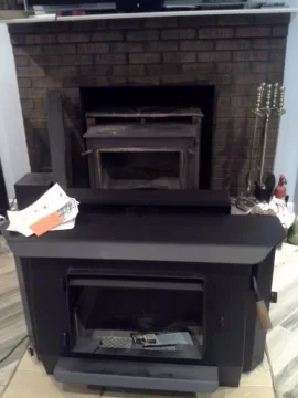

You would be surprised. The thermal images I took of my King showed the face of the stove to be the hottest on the stove. Probably a tie for first with the area directly above the cat. It's not a shock to me after taking thermal pics of my stove, I'll tell you that.

This one was a little while later after the stove got up to temp more but I didn't go back through and take the same pics again, wish I had.

As I recall marshy, those photos were during extended max setting burns. Seems you needed to run that king hot all the time.
I suspect a completely different temperature map when running on low.
The stove was on the max heat setting just like the OP said his was. That's what makes them directly applicable to the conversation. In general, the face of the stove will be the second hottest spot on lower burn rates because there is no firebrick there and the heat generated will primarily be at the cat.
