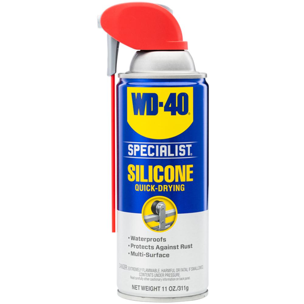

In my experience silicone spray stays dry and leaves no residue at all. It won't attract dust or dirt and waterproofs, rust-proofs and lubricates. It keeps these properties over a wide range of temperatures.
Reactions: Highbeam
I'm going to do it! So just regular silicon spray lubricant?
The product description says the right things. Dries, invisible, will not attract dust, suitable to 500. For use on linkages, hinges, etc.
Honestly I needed silicon spray anyhow since I use it to lubricate and hydrate the rubber weather stripping and seals on my automobiles ant the slide seals on my RV.
Yes, I just buy generic, though I see now that WD-40 makes one. That should be ok as long as they don't add additives. I have been using silicone spray since the early 1970's. I had a 2 stroke Saab which had the distributer right up front. This would get wet and make the vehicle hard to start. I would spray the inside of the cap and the wires with silicone and voila, all fixed. I did this every fall. It's also great for areas you don't want residue to attract dust like the side door tracks on minivans and for sticky metal window tracks.
