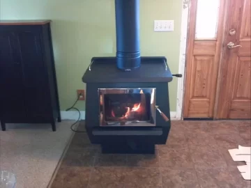

Hello Blaze King Princess Classic Owners: We're about to purchase a BK Princess classic from our local store and I have a quick question. Does anyone have comments about the height of the wood stove opening? From a functional standpoint, have you found the fact that it sits lower than other wood stoves a good thing or something you find you're just living with (in other words, is it driving you crazy)? When we install the Princess on a hearth pad (2" thick) the opening will be significantly lower than the stove we're replacing and I haven't decided whether that's the end of the world or not. We do have some options for making the hearth pad thicker. Other suggestions would be appreciated (apart from purchasing the pedestal model (Ultra) which we we have been leaning away from for aesthetic reasons).
Thanks for any perspectives you may have!

I have a princess on a pedestal and it doesn't bother me. I don't lean over it when I load it, I sit or kneel on the floor in front of it. My previous stove was a similar height so I guess I don't know any better one way or the other. ==c

It's not that low. The firebox of the classic sits up on the funky base that has the holes in it. In comparison to the ultra, the classic is low but that is only because the ultra is so tall up on the gigantic pedestal. Not only does the classic have that holey base but then you have 1 or 2 layers of firebrick plus 6" of firebox depth before you hit the bottom of the loading door. That's gotta be like 10" from the floor.
You'll love the princess. If your knees are in bad shape, you may wish for an elevated hearth. I do all my loading while sitting on my feet. You don't load them often but when you do, it is a full load of 40+ pounds.
