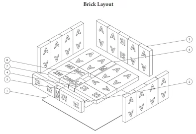

I've only compared the Princess to the Ashford. The firebox shape looked different and has a different firebrick pattern, but I would defer to Chris for the final word there.
Not even my two Ashfords have the same firebrick pattern, so I don't think that's a key part of the design.
That surprises me, particularly with the brick pattern laid out in the manual. Is there a big difference in production date or just a human error?

This is interesting, begreen. Neither of my stoves match that pattern. On both, the floor is laid out differently.
Actually, what bothers me far more is that one of my stoves has enough firebrick across the back wall to completely fill the back wall, but the other does not. They must have used different firebricks between the two, or the firebox sizes must be different. It is very noticeable, when looking at the brick patterns, as the one stove has big gaps between bricks where you can see the steel body of the firebox between, and there aren't enough bricks to keep them all locked in place without moving around. Never having had a brick/steel stove before, assumed maybe they were just all like that, but now that I'm comparing the two I can see one is definitely set up much better.
Both came from the factory with bricks installed, so it's not an issue of operator / store setup mistake. Might be time to ask BKVP about this.

Curiosity just got the best of me, so I started taking some quick measurements, among the filth in the firebox. The first brick I measured, one of the 9" x 4-1/2" bricks on the back wall, is only 4-1/4" wide. That's probably part of the problem. However, I just pulled up the other half of the diagram you showed above, begreen, and there are other problems. For example, the four 4-1/2" size A's that make up the side measure 17-1/2" total, such that the sides don't even overlap the type SI bricks in the diagram, as they should to keep them in place. Seems ALL of the bricks in my one stove are running 1/8" to 1/4" small, which seems to be the reason they won't stay where they should, in the pattern given here:
(broken link removed to http://www.blazeking.com/PDF/Brick%20layouts.pdf)
The result is that I can't keep the two SI's and one QC block where they should be, in the ash lip area. I made due by pulling the SI's apart, to keep the sides in place (four A's), but this leaves a big 2" gap in front, around QC. That's probably not good. Of course, if I set it up the way it's shown, due to the undersized bricks, the A's along the sides can move around and leave big gaps on the sides of the stove, which I figure might be worse.
I think it's time I contact BK to ask for a set of properly sized bricks. It's just a shame I ran this new stove in June, since it will be a very messy job, now.
