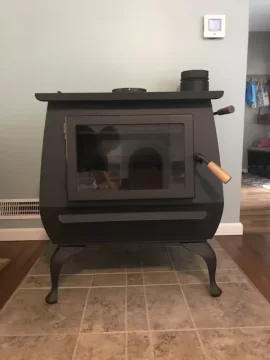

Pulled the trigger on a Princess Parlor. Paid $2700 out the door. The dealer also gave me 10 packs of enviro-bricks to try out free. Feel like I got a decent price. Can’t wait for fall to get it going!

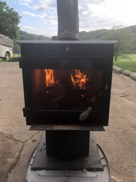

I just fired mine up outside with a 3’ pipe on it. Had to keep door open and figure out good spot but on the 3rd fire I had it up past 600. Decent amount of smoke/fumes off of unit. It was a 85’ day. Installing stove in about a month so wanted to do it now.

Good! I couldn’t do the cracked door trick, or I’d have chanced warping bypass frame or bypass door, and doors wide open runs cooler than doors closed on my stoves. Glad yours went okay, though.
