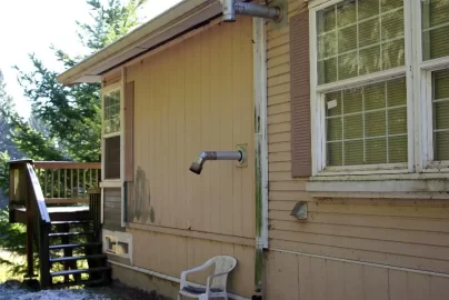

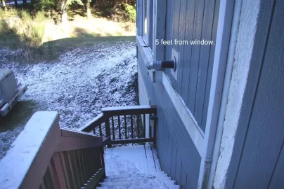

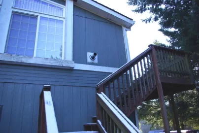

Here are Piccy's of my two Whitfield vent setups.
Direct vent and zero issues.

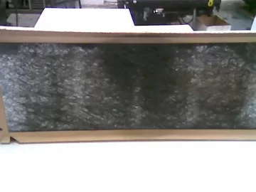

Here is my filter off the back of my unit that is about a month old. It's most dirty right where the exhaust pipe exits the stove......right in the middle above the filter. It looks a lot dirtier in person than on here. :roll:

Soot/smoke coming out of the exhaust connection is different than it just leaking out of the stove at the door or other areas. If the exhaust connection is sealed properly there should not be any smoke leaking there.

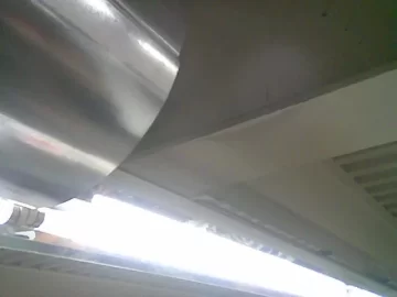

The discharge end of the pipe where the heat comes out shows on a steal beam just in front of it that there is soot streaking on the beam from where it is blowing by it. So it is more than just what maybe leaking around the exhaust pipe......it's actually being blown around the room from inside the unit. Although not really bad looking, the pipe has only been up about a month in that position.
