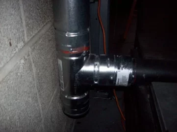

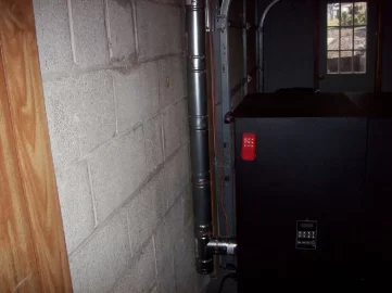

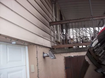

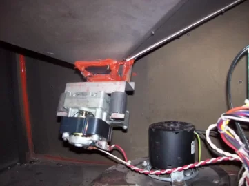

OK finally!! Here's a few pictures.I have attempted to show how the flue pipe exits the house and the stove. I have shown the red rtv hi-temp silicone at the joints and also a picture of the auger that I read may be a problem. I hope this helps. If I need more let me know.....Thanks Mark
Also, the stove did run on low temp when I first got it. It wasn't very cold outside then! It is not on a stat. It runs only through the night for supplemental heat. number 2 setting on automatic burns 2 bags a night. House has hot water heat so no existing duct work. There is a place for a filter at the rear of the stove where it gets fresh air however there is no filter there. USSC has them on the website though if you think that will help.

How about an appliance adapter? After looking at the pic I see it. Please disreguard

I see one issue with the vent cap. Its kind of close to the house. Should be 18 inches of clearence. Second is check the vent for leaks. Dim the lights and check with a handheld light to find the leaks. Best to do on first start when stove smokes the most. The following area's are noted problems spots to.
stoveguy2esw(mike) mentioned the tee cap cleanout area. They seem to leak there pretty bad sometimes. Use tape here so you can cut it to remove the cap for cleanings.
Eric mentioned the appliance adapter. It should also be checked for leaks. There is a gap around the inner and outer walls. I usually fill the gap with silicone and sometimes even tape over it.
At the seams where you added screws. And also most of the seams on this particular vent system have been seen as leak spots. All seams and joints need to be leak free in the house. Take your time and check them carefully. Especially if there is a hint of wood smoke smell from start start up. Sometimes hard to tell on manually lite stoves!

I am suspect that the black soot on the side of the house could also be getting sucked in around the front door ???
The terminus is sopposed to be a minimum of 12" from the house.
Depending on the way the wind blows that cap could be pickup up wind and causing issues.

Is that a garage door to the right of the vent pipe??? How far away??
Does the garage connect to the upstairs ???
Garage doors are not air tight. The soot could be entering around the rollup door than taveling right up into the house.

I went back and looked at your picture a bit more.
The vent is right next to the garage door and also the overhang from the Portch roof is likely trapping the smoke right close to the front door area.
I hate to say it but the most likely solution is to run an Up pipe to above the roof level.
Post a piccy that shows a straight on shot with the stove vent, the front of the house and the roof above.
Adding pipe along with a cleanout trap outside will not hurt anything and will most probably stop the soot issue.

Also, all that soot outside in concerning. The stove should not be burning that dirty.
On another note, it is probably a code violation to have that installed in a garage like that. If it sucked up some oil or gasoline fumes while running.... BOOM!

Your venting situations is atrocious. If you are capable do it yourself, otherwise hire a pro to run that vent up above the roofline.
Your stove is too big to vent into that area right underneath that overhang and right next to the garage door.
here's another thought for the soot on the outside of the house.... is that exhaust on the north side of the house? i have seen quite a few here in maine with a northside exhaust, and the side of the house covered in black soot. could be someone will say it makes no differance, but just a thought.

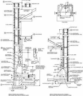

Shortstuff said:
I would extend that exhaust pipe vertically through your soffit, roof and then up high enough to be within code - perhaps 8 to 10 feet.
Pellet vents don't have to meet the 2/10 rule as far as I know. I think the Quad manuals just say to be 2ft above the roof. So if you go this route, follow the manual but you might also need to go higher if for some reason local code requires it.
Here in my town, the inspector treated the pellet stove exhaust just as he would any flu/chimney as you can see in the current code below.
