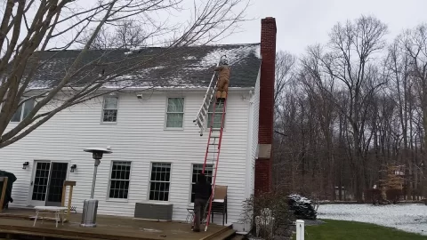

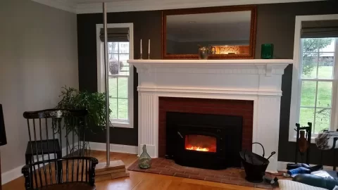

Hello. I'm replacing a Regency I3100L and wondering if folks have an opinion on which might be a better unit for my case, the Blaze King 29 or the Pacific Energy Summit LE.
Both of these units have a larger firebox and I have a great deal of firewood cut at approximately 18", as the Regency I3100L had a generous firebox (2.9 cu ft I think), and could handle a max log size of 20".

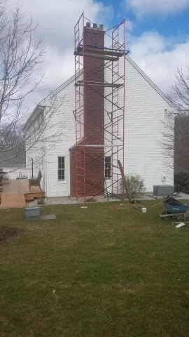

Home is a typical two story colonial, outside chimney with ~28 feet of insulated 6" flue. It is generally in the upper 70s and 80s in the rooms near and with the current insert and upstairs in the 60s. It's been PERFECT for comfort in the evening and sleeping. Move some heat around with fans and the like.
I understand the PE Summit LE is the most like my old Regency, non-cat with removable baffle, and the Blaze King is a cat unit with a recurring expense. That said, I believe the BK Princess 29 qualifies for the tax credit (assuming that credit is something I qualify for).
If it was one of these two units, what would you chose and why?
I appreciate the help and opinions.

What ever stove you choose get your draft under control. The princess will give you lower output than the 3100 but it will be much more even.
I have no reason to believe the draft is not under control. The unit would cruise right in its sweet spot for an hour, hour and a half and slowly come down. New dealers and installers that I've talked with say there's absolutely nothing wrong with my setup and they would install it per the manufacturer's recommendation. Nothing about my setup is different they and do tons of two-story colonials just like mine.
But thank you.
I am simply trying to keep you from having another stove fail prematurely.
Btw that short of a sweet spot is another sign of excessive draft.

I do wonder if the newer stoves are less easy breathing, so if there is a strong draft the newer stove would have more resistance to that draft. I'll still inquire about getting it measured .
That's true...I wonder if between the adjustable height legs and top or rear flue connection that some models have there is something in their offerings that would still be of interest? Guess it depend on the dimensions of the fireplace, and how tied OP is to the traditional insert (with faceplate) look...
Really want something functional and have some latitude on looks. Fireplace is 28 in high and 40 in wide. 20 in deep. So I don't know if a rear exit on one of these could work. It would be interesting if and it would be a look that my wife might like as well. From what I have read inserts are the best way to go for the situation I have. Not sure if that is true or not.

Instead of spending money to have it measured, I can put that money to adding a damper. Worst I do is run it opened if not needed. There is very little room for a damper above the unit. 28" high opening.

How much does it cost to have the draft measured? The process is not super complicated. I have the tool to do it. I will probably never use it again. If you want to measure it yourself and pay shipping both ways you can borrow it.
One damper doesn't cut a lot of draft. I have two dampers in my SIL's connector pipe and it cuts additional draft. That would be tough to do on an insert, though. I'd have to believe that tall chimney has a very strong draft, but you'd know that better than I from first-hand experience.
I won't go into some of the other ways to reduce draft, if excessive draft IS an issue. Now, it might be less of an issue with the BK, since you can cut the air lower in a cat than a non-cat. High draft could still be a problem for a cat stove, I think.
