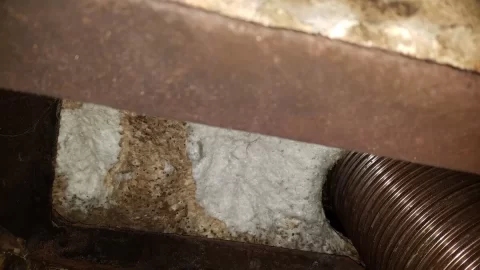

Is it underperforming? Appreciated mention of shortcomings in manual, which were addressed in later versions. Although you're not using the shroud, is there a block off plate?
Minus the shroud, there's more room for our kettles of water to keep the humidity up. And we don't need to run the fan very often with the stove exposed to the room air. The flex pipe is insulated, about 14 ft long and run within the clay tile liner of an exterior chimney and sealed at the top (below the cap), and blocked at the bottom as pictured. The Princess is performing really well. We have a cord+ of 2-3 yr old mixed hardwood (@ $200/cd) outside. and a one-ton pallet of SWI Bio Blocks @ ($309) inside. Bio Blocks (1 ton) claim to have BTUs equiv. to 1 1/2 cords seasoned hardwood. The store doesn't deliver, however my trusty '95 SAAB 9000 and I brought home the 1 ton pallet load in 3 trips. Slightly over the vehicle's load capacity. I'd heated my house in the 1980s with a large LOPI insert - a smoke dragon. Then came up here to NE PA in early 2000s, heated with a Mama Bear modded to sit within the fireplace before buying the Princess. The house has Oil HWBB, but it's job is making our hot water and only occasionally heating the house.
