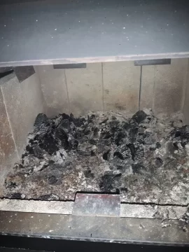

When you turn your stove down and the alarms go off what does the wood inside your stove look like? And how does it react if you turn it all the way up? When your done burning what does whats left look like?
@Rickb the wood was chard and once I turned the temp back up it ignited again and burned until see attached pics on high with my windows and doors open until the fire was out. Ive also had a bit of leakage during light up but it happend with my last stove randomly too so I usually crack a window when I start fires. I just talked to BK today and due to my regions temps their units cant do an overnight burn its " too " warm out works better in single and minus degrees. Its supposed to be 13 and rain next week id like to use my fire to get the damp out. Also I was still in the active smack dab 12 nd my house was filling with CO, I also re looked at my lines on my dial and im inbetween 3-4 not 2-3 as previously mentioned. I still have yet to check with a bag as well work gets in my way. Overall not too happy that an apparent special temp has to be outside to have a fire as Ive never had this type of issue in the past I think im going to look for a non cat stove. I dont mind if a fire dies middle of the night and I have to learn to tweak a setting to make it burn longer but not when it leaks CO and im told to fiddle with the thermostat, that means you don't care for your customers health in my opinion.

I have one final thought: Can you see where the chimney runs through the attic. Based on your pictures the connections don't quite make sense to my eye. Is there a connection in the attic that has come apart filling the attic with CO and then allowing it to infiltrate the house?
100ppm is a lot of CO to get in a house from a wood stove. Especially if it's occurring multiple times. I feel this is something much larger than just a pinhole leak somewhere. I would think it would be quite obvious, and the attic is really the only place we can't see from the photos.
