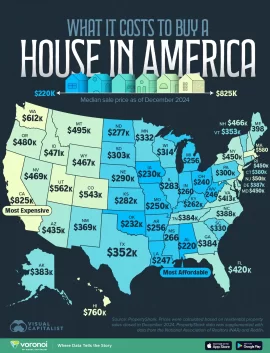

I have no idea how to delete that unrelated image below but hey, ND looks like a cheap place to live!
