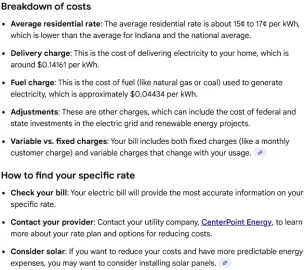

AI sez;
[Hearth.com] Blazeking or Pacific Energy - 1st time buyer
I just took the total of my bill, minus state tax, and divided by kWh, came out to 25 cents/kWh.

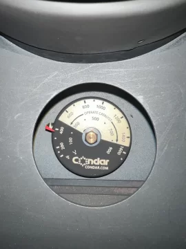

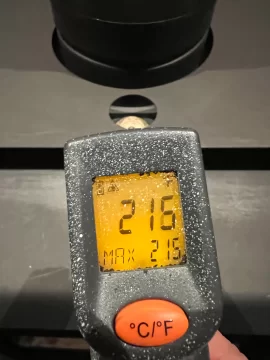

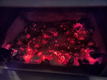

I’ve never burned a PE so I can’t comment on one of those, but am on season 11? with my blaze king. It’s everything you read about, boring to operate, sips wood, steady consistent heat with long burn times. I ripped out a free breathing tube stove to install this when my work had a change of shift times and I’d be away much longer than previous. I wanted to come home to something at least. Today since reloading 37 hours earlier I still have a warm house with a coal bed enough to keep the stove around 200+ degrees ready for a reload off wednesdays coals. This is with hardwoods, with softwoods cut that time roughly in half.
Any other questions feel free to ask.
  • [Hearth.com] Blazeking or Pacific Energy - 1st time buyer

Absolutely. It’s 4 cubic feet and I try to use most of it. I heat 2400 sqft floor space with a great room with 2 story ceilings with a loft if that equaled floor space it would be 3ksqft. The BK line in general have the same characteristics, princesses can go 24+ hours as well. Especially with a smaller house and relevant thermostat setting. This was the 37 hour tank of fuel;
