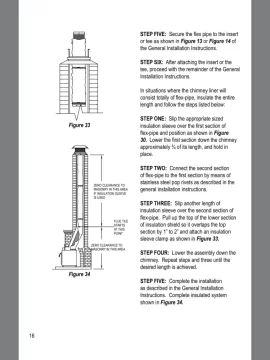

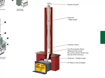

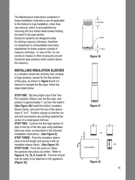

    Well this brings up another point, and the more I read it's hard to remember every post on the subject, so I could be miss quoting. The installation instructions shows the insulation sleeve covering just up to the flex, one photo shows connecting the flex directly to the insert flue and the other picture shows using a flue connector not being insulated.
    I've read somewhere that the flue connector is going to be the hottest part of your linner and the reason you don't want to insulate the connector is because you don't want to over heat that connector you want the heat to come off that connector into your fireplace to heat the stove.
    Please Correct me if I'm wrong or did not understand.

    You will not overheat the connector. And no you do not need the heat off of an uninsulated connector to heat your stove or fireplace. It's usually not imperative to insulate the connector but the chimney/liner is only going to perform better because of this extra insulation, not worse. I'd be curious if others have different thoughts or if you recall were you read that the connector/adapter shouldn't be insulated. Look at your last picture closely. It shows the insulated flex going directly to the insert.
    If there was risk of overheating a few inch long connector by insulating it there would be strong warnings in the install instructions against it.
