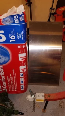

alright everyone! Thank you to EVERYONE for your help. I was planning on doing the chimney insulation and block off plate this weekend, but looking at the weather report, i went out last minute like 10 minutes before lowes closed and got a whole package of roxul, and steel. I started last night, i stuffed about 4.5 of these massive pieces into the empty gap of the chimney, and in the walls around the stove. I started the stove from a cold start, and the house has jumped 2 degrees in 30 minutes already. The insulation is holding heat very very well. My block off plate is pretty raunchy so ill redo it in the spring, but i can tell this is going to make a HUGE difference. Thank you everyone!

Good to see this worked. You were losing a lot of heat to the masonry surrounding the insert.
I noticed quite a difference on my thermometer when I did mine, I don't think I used 5 pieces but it can't hurt.
Well to give an idea of how well its working, the insulation is holding 150* heat so far. We already have 3 or 4 inches on the ground. So bring it on!

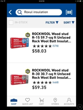

Is this the product?
So it must be fire proof if your putting it around your liner, do you need to keep it any distance away from the insert.
Roxul is made of mineral fibers. It is non-combustible.
