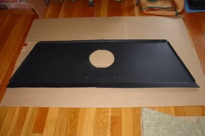

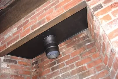

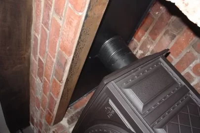

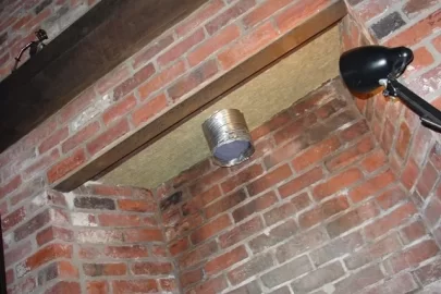

Make your plate out of stainless or regular sheet steel. Avoid aluminum or galvanized as they are not a good choice due to the high heat environment. You could use 22 gauge, 24, 26 - it doesn't much matter. You can either make it in one piece or two side pieces - whatever best fits your situation. You want to insulate above the plate with 1-3" of fireproof insulation - something like Kaowool or Rockwool or Rockboard. I used 2" thick Rockbard 60 or both my lower plate as well as the upper one at the chimney crown. You can secure the plate by wedging it into place and screwing it into the mortar joints with Tapcon screws. Seal it along the perimeter with high temp silicone, Rutland clear or red. If you search the forums you can see variations on the theme.
The block-off plate really seals off your fireplace smoke box and chimney from the rest of your house. It works exceptionally well to keep the heat in your house. It will pay you back for years. It also acts as a safety device (fire door) should you have a chimney or flue fire.
My supplies:
22 gauge sheet steel painted black with 1200°F stove paint
2" thick Roxul Rockboard 60, gives an R value of about 8
Rutland Clear 500°F silicone
Tapcon 3/16"x 1-1/4" self-tapping masonry screws
