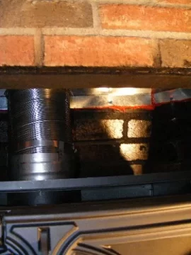

Its pretty easy to open up part of the damper throat with a 4 inch grinder and cut off wheel. I put in the Roxul or rockwool with the block off plate and around the liner at the cap. My chimney sweep said that the rock wool would be better with something holding it in place. The block off was real easy to make and install.

Cut the damper out enough to allow the liner to remain round and pass through.

well, the last thing you stated is exactly how I am fabricating my blockoff plate. I am doing a 2" flange on the back and two tapered sides (trapazoid shape), but the front is flat and will be directly screwed into the back/bottom of the lintel. But, I'm new to this so don't write it in stone. I will be packing some ceramic wool above the plate and around the edges where it meets the firebox. The only mod that I may have to contend with is widening the flue cutout if it occurs where the stainless flanged attachment is, instead of the the sleeve.

The plate can be made of the galvanized flat stock Home Depot or Lowes carries in their duct work isle.
I think its 26 gauge. What they have is fine. Yes you can install it a little lower if it makes it easier to install.
Seal the perimeter of the plate at the fireplace walls with high temp silicone. Seal the gap around where the liner passes through the block off plate with Rutland furnace cement or other furnace cement.
Try to keep that gap as small as possible, anything over 3/8" and the cement might crack and fall out.
Brother Bart gave an excellent suggestion of stuffing stove door rope gasket in the gap if it fits.
Its easiest to cut the whole in the plate, run the liner through, anf use a smaller round or square plate with more exact hole and a slit to slide it over the liner and into place then screw to the main plate.
It has to be effective, not purdy.
If you search Iceman's posts or PM him, he has some excellent photos of the block off plate installation he did.
