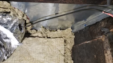

The block off plate fits at the top of the firebox, in my case immediately below the damper and at the top edge of the fire brick. I split my plate into 2 pieces to make is easier to fit around the liner. After pushing it into place I used 2 tapcon screws to secure it to the firebrick. Then caulked the exposed seams with high temperature stuff. Used roxul to stuff the gaps around the liner.
