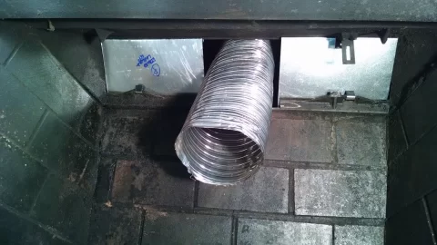

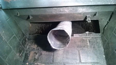

Okay, thanks everyone for offering their opinions on the block-off plate or not. It seemed the consensus was to do the block-off plate, so I did. Here are 2 pics (before & after). Yes I will fill the small open area immediately around the liner with Roxul before shoving the stove in. Please lmk if anyone sees a problem with this fabrication & install. When doing the block off plate I noticed some small dents inside the liner which certainly happened form shoving it down. Does anyone feel that is problematic damage to the liner or something that happens on most liner installs?
It happens with many installs of those smooth wall liners yes and in my opinion it is problematic which is why i will not use that type anymore. I can tell you those spots will collect more creosote and will probably fail sooner that the rest of the liner. It really is your call as the installer. If i was the installer i know what i would do but you wont like to hear it.

Thanks, the way the flu is shaped the liner comes in at an odd angle (front to back) relative to the stove pipe. So, I chose to leave myself the flexibility to be able to move it a bit to connect everything. Once connected I figured I would then fill the void with the Roxul. I am waiting for a 15 degree connector to arrive to help handle the liner angle.

Tear it out and put a good liner in that is not damaged. I took out the only 2 liners of that type that i installed at my cost because i did not trust them
