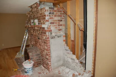

Come the fist of the year we find our newer wood floor is infested with powder-post beetles. Since the flooring is coming up we decided to shrink down the fireplace to regain some real-estate. The room is 15x32 and from the edge of the hearth we have 10' to the back wall. The unit takes up 50sf in total. The idea was to remove the unit and rebuild a much smaller structure.
After removing the 4ft on the right I ran into the liner of masonry heater. I also found that the chimney stack is supported by the front and back of the brick walls with angle iron. This prompted me to rethink this a bit and to understand exactly what I was dealing with. Come to find out we weren't burning the stove correctly and all the heat was escaping because we were not closing down the damper.
Our current situation is torn up floors, torn up masonry heater and an unhappy wife and we men know what that leads to.

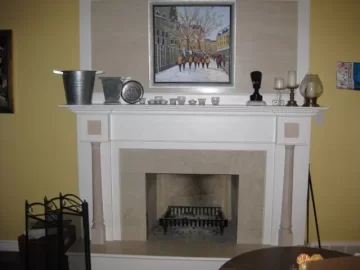

Hope the pictures show... only pic I could find of the current unit before demolition.

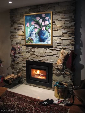

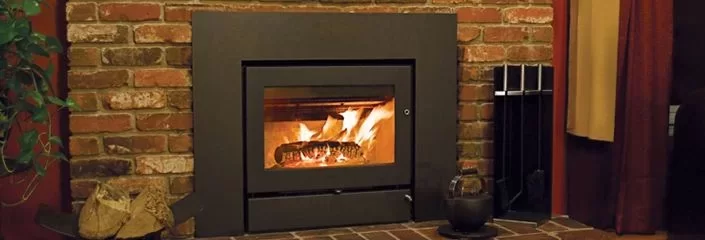

Thanks for the feedback. The stove takes on a completely different shape and look by ordering the blower model. This would also require we build the firebox to the correct size depending on the model selected. The plans were to recess the unit into a finished ledge stone box and avoid using a large trip kit. We love the look of the standard stove with the thin 4 piece trim vs the larger trim found on the unit with the blower. Two retail salesmen said a blower would not be necessary with this unit but I'm seeing a difference of opinion from insert owners. Is this unit that good at radiating heat that a fan would not be necessary?

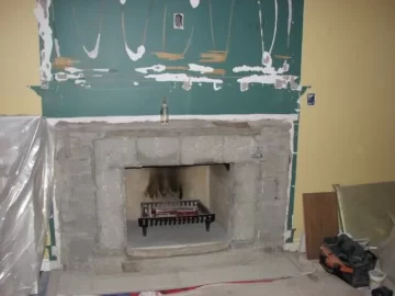

I have the Morso 5660 without blower. I had a custom surround cut from the original as well. I have included before and after shots. We heat our 2400 ft2 bungalow with natural gas forced air. With this unit our gas use was down 30-40 percent. The living room is 30 by 15. This unit heats this room plus our kitchen (26x 16) without difficulty. The bedrooms (4) get chilly, say 65-67 degrees at night because the furnace is not called on from the fireplace. I use a fan to try and disperse the heat elsewhere in the house.
There are no overnight burns with this unit. It has fantastic ambience. I love it. I love this site too for that matter.
