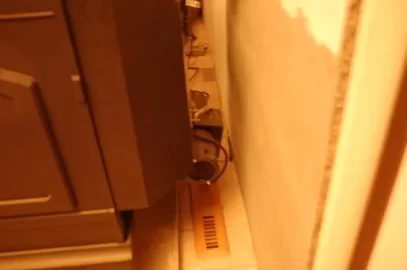

the fan kit (including the blower motor) attaches directly to the back of my Dutchwest stove (see photo below). The black panel on the back of the stove is not the edge of the firebox tho, so think of it almost like a double-walled flue connector. I can put my hand on the motor for a little while w/o burning the skin, altho it does get warm after several days of continuous burning w/ the reburner engaged (which is also on the bottom rear of the stove). The circular fan section has a cutout on each side on the top, each of which vent into a baffle that runs up the back of the stove, then angles towards the front of the stove between the firebox & the surface plate. The baffles then rejoin and exit out a cutout in the front of the stove. The air coming out the cutout is exceedingly hot and does a great job of increasing airflow to the surrounding area/rooms.
I dont often leave the motor running overnite just because Im cheap and dont want to use the electricity, and the cat would be the only one enjoying the heat exhaust.
