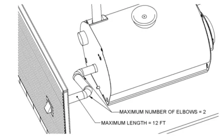

I don't interpret the statement above as meaning a Garn could be legally installed in a garage in Maine. The Garn does not get it's combustion air from outside, which is a requirement in Maine to be installed in a garage. It would pull combustion air from the garage which is where things get tricky for fire (fuel storage in garages and the like).

It looks like entry into the space can only be done from the outside so no doorway from garage into boiler room. installing a fresh air damper would cover this IMO.
