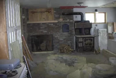

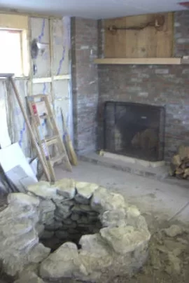

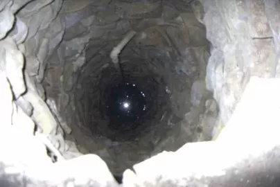

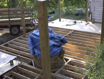

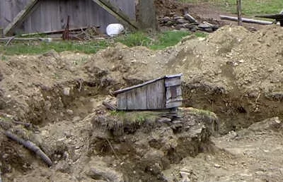

Here are two wells I have, one is a dug well where water comes to ground level in the spring and 20' down in mid summer. The well used to be in my backyard with a little well house sticking above ground. I dug around it, built a two-story addition to the house around it, and the well is now inside the house.

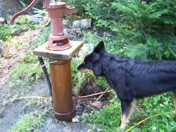

The other well with the pitcher pump is one I drilled 225 deep at my Adirondack mountain cabin. It would up being a real Artesian well and runs out of the ground, all the time. In fact, I've run a pipe 20 feet in the air and it still runs. Note my dog enjoying the self-service water supply. We use a hand pump plus a spigot to fill buckets with no pump needed. Hand pump just makes getting a lot of water faster.
