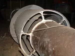

I have an 8" triple wall chimney that was left in the barn. Can I use that 8" with the 30-NC (6" flue) or would I be better off getting all new chimney?

If you are inside the 8 inch might make it, but you would be better served by installing a new Class A so you would know exactly what you are dealing with.

Thanks for the reply. I think I will go with all new chimney and pipe. If for no other reason than to make installation / mating of ends easier. I hate frustrating projects.
