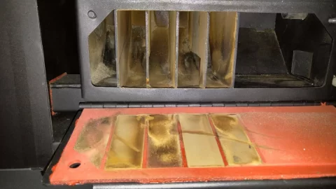

Did the first cleaning after running on levels 3-5 for the last 4 days. Glass was about 60% opaque/blacked out. Firepot cleaned x2, some carbon deposit and small clinkers, but not to bad. Chamber directly below firepot had some ash. Opened the cleanout door and found enough ash in last baffle on left that might have slowed the exhaust flow ( see pic where most out the ash was cleaned out already) .

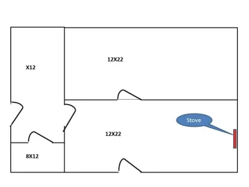

how well did it heat
My shop is about 850 sq ft and well insulated 6 in exterior walls. The person who built it made it to use as a music studio so all interior walls are 4 in and well insulated too. Since I started using the stove, the outside temps have averaged between 32 at night and up to 50 days. The stove keeps the whole shop at 68-70 on level 4 (out of 5) easily. I am not sure it can keep the whole shop that warm if it was close to zero. FYI- I have been using a small oil filled electric heater to keep the stove room by itself at 45-50 degrees during winter and it will only get it up to 55 if I turn it full on.
My plan is to use the stove to heat the shop, excluding the other big room or about 580 sq ft maximum and I think it will do that easily.
