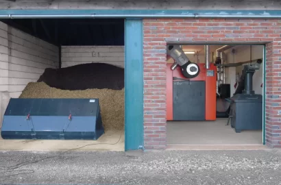

I think it's all about automation.
I personally would not like to fill cord wood in any wood boiler over 200,000 BTU/hr (60 kW)
With a wood chip boiler, you can fill your storage for 1 or 2 weeks at a time and still be able to "enjoy" life
This picture is a Heizomat (Germany) wood chip installation.

This is it in a nutshell.
The convenience of pellets in a greener form (chips require less energy input). Plus its a form you can make reliably yourself. Logs, yard waste, general forrest biomass.. all goes into the chipper.
Think "mechanical" firewood.
