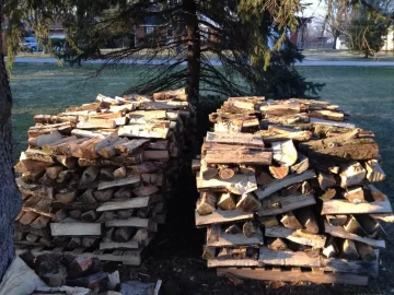

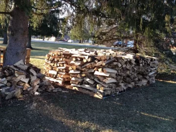

I got the box elder from a friend. He lost the tree in the summer of 2011 and cut it up but couldn't split it. He offered me some of it if I brought my splitter over... Can't beat free wood! There was about 6 cords total from this tree! He kept 2, I took 2 and another buddy of his took 2. Should be well seasoned and ready for shoulder season next year! Think it would be a good wood to break a new stove in with?

I'm not wood ID expert, but I thought box elder have a ring of really bright red in them? I don't see any of that in the splits above.
