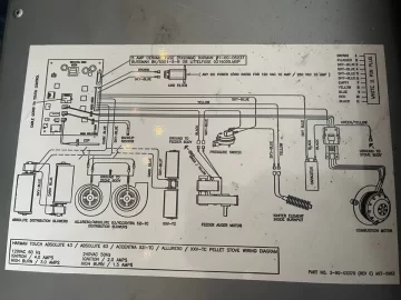

Hey everyone. My family just got a new 52i-TC installed only a couple of months ago. Everything has been working just fine, only recently started using it on a regular basis, but I have been doing the cleaning typically prior to the notice displaying on the screen, trying to keep it very clean.
The other day my wife said that the flame slowly dwindled to nothing (while it was on constant burn) and she was unable to restart it. When I got home, some of my initial findings were that there were no pellets even in the auger screw, and when I would turn it on, the auger screw would never spin.
Digging a little bit deeper, I pulled all of the pellets out of the hopper, the feeder door was shut, otherwise, I could not feel or see any obstructions. In the test menu, when I turn the fan on, the pressure switch closes properly. When I turn the auger on, nothing os turning. When I try to ignite under constant burn and then go into diagnostic mode, it shows the feed motor as ON and the feed rate at 37%, but nothing is moving. The feed door at the bottom of the hopper is closed and the auger is not spinning.
Our local dealer who installed this will not be able to come and look at it until January 6, which is extremely irritating on its own. We were looking forward to burning pellets all winter instead of expensive oil so this is very frustrating that it is already broken.
Has anyone experienced this or have any suggestions for me to try? I am extremely handy and am more than capable of testing or checking things out. I did quickly pull the unit out and check any cabling, fuses and stuff. Cables all seem in tact, I checked the ground from the feeder assembly and it’s a good ground, fuse is fine (wouldn’t power if it wasn’t I guess). Any help is greatly appreciated! I’d prefer to get this running before Christmas if I can, but if it will require a warranty replacement feeder assembly or something, obviously that’s out of my hands. Thanks in advance!

Welcome...So others should come aboard here, but is there a hopper switch, all doors fully closed with no obstructions, you know how to use a multimeter to test for voltage at the auger motor when auger lite is on ??

I turned on the combustion fan, ensured the pressure switch closed, probed the black wire feeding to the auger motor at the main board and it reads 120V once I turn on the auger on the control screen.
Power at black and sky blue wires at the auger motor ?

Yeah, it seems there is no way to check those wires at the motor, they are integrated into the unit.
