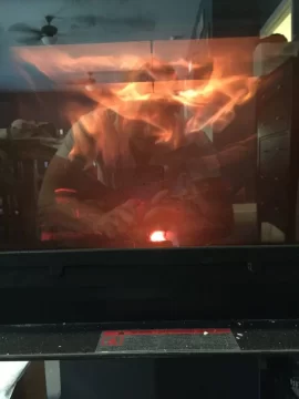

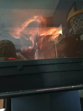

Got a couple of pictures from the second break in fire this morning.

Looking good. How hot did the stove top get?
It got right up to 500 and i cut down the air and it held there for a pretty good while. Had all the windows and doors open to air out the house. I loaded the stove with some small splits and some small rounds about maybe a 1/3 full and 6 hours laters there's still a nice bed of coals
The paint is probably about 90% fully baked then. If you do another fire take it up to 600-650F and it'll be done.
