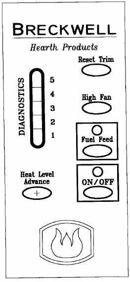

Hello
I just got an older Breckwell P2000 FS 3 sided glass wood pellet stove with the original digital control board. This board does not have the Mode switch for the T-Stat on the control panel.
I did fire it up and it seems to work well and is nice and quiet!
Original Breckwell P2000FS Manual C-L-802 8/04 on Page 14
See pic 1 below and older manual pdf attached below
Newer Breckwell P2000FS Manual C-L-802 8/04 on Page 14
http://www.pelletking.com/pellet-stove-manuals/Breckwell-P2000-Pellet-Stove-Manual.pdf
See pic 2 below
Has anyone upgraded to the newer control panel?
Is there a good place to buy it cheap?

Don,
You might want to look at the component side of that board, get the timing chart and look over the selection of those boards that enviro and others are using.
It appears to be a re-branded bog standard third party controller.
