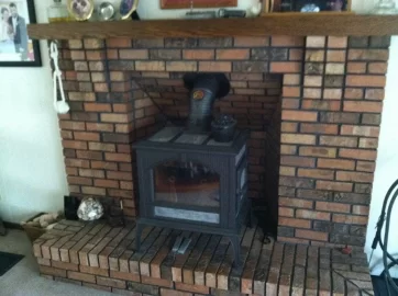

I rebuilt my fireplace and stuck a Woodstock inside. [Hearth.com] Brick mason out today maybe a stove change

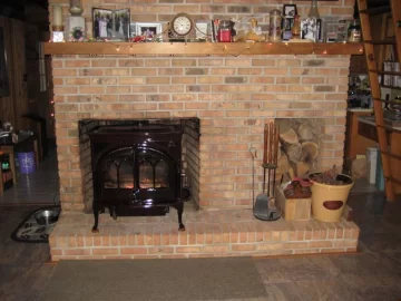

My Jotul F 600 stove is set up something like what you are proposing. I measured the height of my hearth and the legs on my stove and it comes out to 18". Here are a couple of photos so you can see what it looks like. I think having the stove up off the floor level makes for better fire viewing.

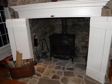

Our family room:

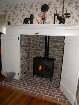

Our den (excuse the wallpaper... left by PO):

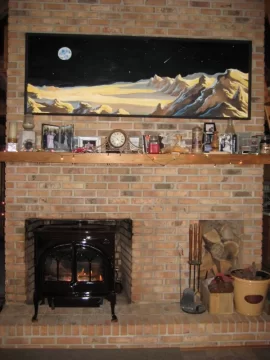

Here's what it will look like with a big steel stove in the fireplace. This is BrotherBart's first firing of the 30NC.
