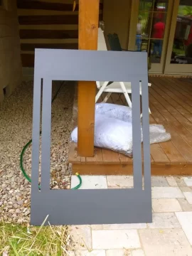

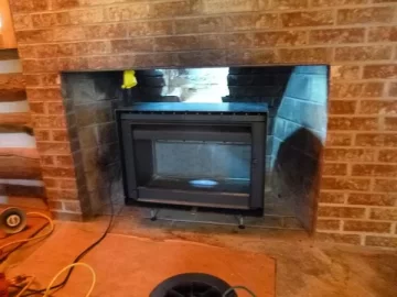

We opted to go with a Morso 5660, simply because I like the aesthetics and we knew the quality. Our opening was quite large, so we needed a custom surround. Fortunately, we were able to custom design the surround to create two essential features: two 1/4" slits on the top and bottom, to promote natural convection around the firebox, and a 1/8-1/4" reveal around perimeter of the surround for more air movement.
After several months, I am pleased to report that it works like a charm! Very clean-burning, efficient, and definitely sends some warm air into the room as well as heating up the brick chimney face.

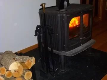

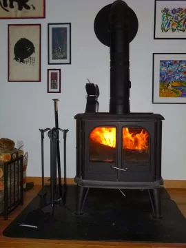

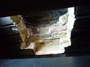

I attach several pictures of the installation, so you can see the opening, the bit of demolition required to get the insert discharge up into the chimney, and the surround prior to installation. I also attach pix of both the insert and our original Morso (with one view of the side-loading door) in operation.

Looks great! I really like the insert, if I was to put a stove in my other fireplace it would probably be the Morso, we also need one that convects without electricity.
I love the look of a lot of Morso models.They are just so damn small compared to what I need.
The 3 cu ft 3610 is a pretty serious big, radiant heater.
