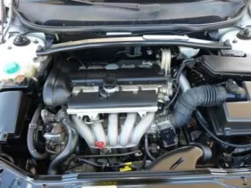

We just bought an older low mileage car from southern Florida. It arrived yesterday and it was pretty stunning to see a 12 year old car in far better condition than the local 1 to 2 year old stock with similar miles we have been looking at. So, other than it not having seat heaters in it, is there anything else I need to think about? It is undercoated, not quite like a new one here, but is protected.

Agree with Bubba. Plus you'll probably want better tires for winter.
And I always changes all the fluids and filters on a used car as a matter of course so you know where you are starting maintenance wise.
The Suburban is sticking around for snotty weather, firewood, compost and camp duty so the all seasons should be fine. I'm checking the antifreeze today as that is definitely still an issue here. I also have read that they sometimes put different thermostats in southern cars?
That car, being a volvo, is good to go. You're not dealing with a kia. The stat, the antifreeze, will be fine and it probably even has an OEM block heater. Maintenance will be typical for any used car purchase. Just hope that the automatic transmission holds up, that's the weakness on modern vehicles.

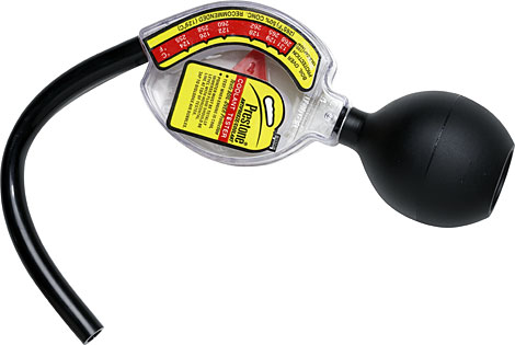

I would still double check the coolant since even old coolant can look good. Hydrometer type testers are available for cheap. Usually $10 or less.

thanks MM, will do.

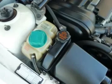

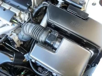

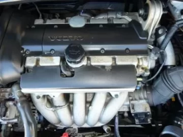

The difference is stunning. You really see it under the hood. 2 year old cars don't look this good here let alone 12 year old cars.

The wonky 5 cylinder. Timing belt is important. It will be the tranny that kills you if the body and the timing belt holds up.
