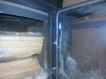

25 years of wood burning, just bought the Hearthstone Manchester in November. We returned from a few days away during Christmas, loaded the stove, lit the paper, a log shifted fell against the glass and "crack", all the way across the front.
I've have had a log or two fall into the glass over the years, first glass issue. I've always been nervous this would happen.
Dealer will replace the glass. The thinking is the log hit right at the edge of the glass and it may not have been installed correctly allowing the glass to rest on the cast iron?
Anyone else have such an issue?
Anyone ever consider replacing the glass with a steel plate?
This of course is happening during the coldest spell of the winter... and no wood stove to warm my toes.

Here is a picture of the crack. It goes all the way across the glass.

I took my door off, went to a local glass shop and had it replaced within 30 minutes. It was a $0.75 a square inch ($176) but I will be warm this evening.
I'll keep the replacement glass, whenever I get it, as back up for any future.
The log hit right on the very edge. The glass shop guy said this is where glass is its weakest so perhaps that impacted the crack? Couldn't see any defects.
It fell into 3 pieces when removed from the door, so it was good an broke.
