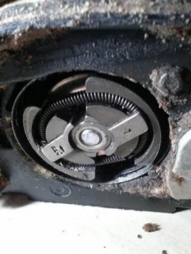

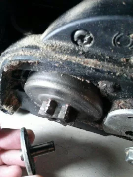

The shaft broke this afternoon on my 16" Poulan Pro. It is model # PPB3416. Does anyone know if this can be replaced without a complete tear down? [Hearth.com] Broken Shaft Poulan Pro [Hearth.com] Broken Shaft Poulan Pro
Honestly I'm not really sure how it happened. I'm pretty good about keeping an eye on the chain tension. I was bucking some smaller limbs and it appeared the chain jumped off and then grabbed hard and stopped. The replacement part is not too expensive, less than $40, but I'm not sure this is something I want to tear into especially right now as my only other saw is 22" which is a little big for what I need to get cut.
If you did replace crank shaft (and probably seals), you'd have more $ in saw than can probably sell it for. That's a cut off spot for me. And that's after a bunch of labor. Lots of options in small saws - low price rerurbs at VMInnovations, CL, big box store or dealer.
You gotta take that whole sucker apart. According to that link above it looks like $45 for that crankshaft assembly. That sounds about right. I'd source another saw for parts, or another saw with a good crank, but shot piston/cylinder. Either way would probably be cheaper. I'm going to go look at ebay right now. brb...
Ugh. Just buy a new saw, lol....

I would. Not worth the $ on a homeowner Poulan. I would only repair if I found a non running Poulan for $5-10.
You've got two choices from where I sit.
1. buy another one like it. I wouldn't recommend this to someone who had NO saws, but you've got a whole parts saw to fix the "new" on if anything goes wrong!
2. Buy another saw that is not like it. Throw your saw in the shed until you run across another CHEAP one to combine with it. Seriously, like $15 bucks for a carcass.
