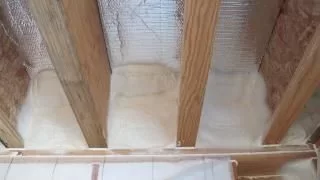

[Hearth.com] Bubble/foil insulation I did staple the stuff to the bottom of my "I" joist flange (16" BCI's - under warmboard) which in turn left the 1.75" space of reflective space, rolled the end of it back on itself & and I spray foamed the ends of the joist bay at the rim board = dead air space..... I put a layer of fiberglass up against the foil (from the bottom) makes for quite floor and warm feet :)...8" walls and the foil stops 3" inside the building envelope!
